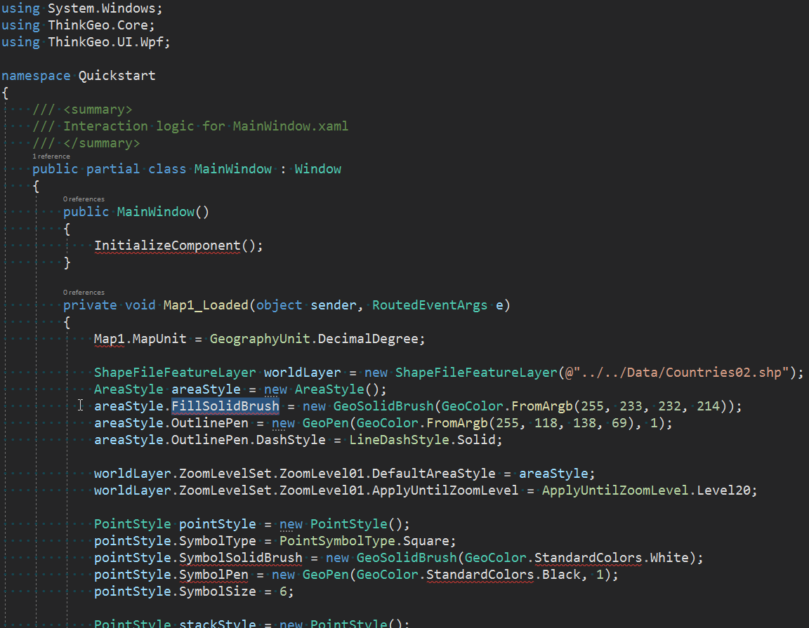

You will also need to manually change some of the classes to fit the new Map Suite 12.0 locations of the namespaces. The commented code is the previous code with the corrected code underneath. See the image below for reference:
